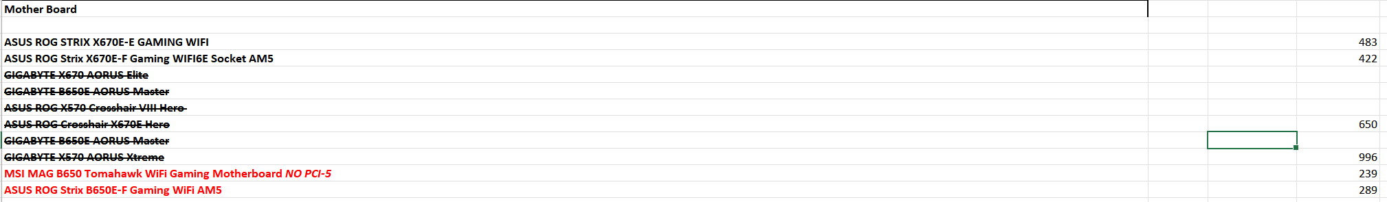

After extensive reading, I decided to go with the AMD 7800X3D (Purchased yesterday). Main reason why I went with AMD 7800X3D vs Intel Core i9-13900K. Heat, Watts & Gaming performance comparisons. I also have no need to concern myself with Gen 5 concerns for the near future based on most of what I have read so far. I cant count how many videos I have watched along with reading articles. I appreciate the knowledgeable feedback I have received here and will continue to post up with questions. Now the next journey begins. Selection of motherboard, then its RAM. By the way, I found what I believe to be the best informative video regarding AMD MOBO selections. This really cleared up alot of confusion for me.
So far my list for MOBOs are as follows, the ones with strike through's have been omitted due to some lack of features, such as lack of full audio suite on back Panel and small amount of Rear USB ports or cost.
