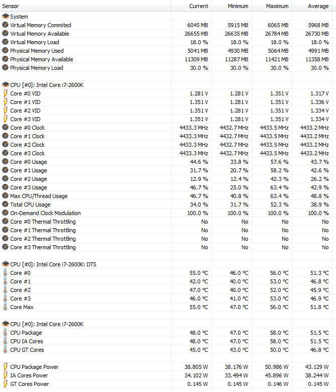

Sometimes, when I'm barely doing anything (even when the PC is idle) it will still freeze. Plus, when I tried Windows 8, I was barely doing anything everytime the PC froze.
These are usually what my temps and everything else are:
I thought it was my old PSU that might've been causing the issue, so I bought this one thinking it would solve the problem.
