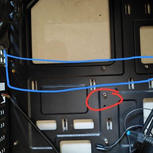

So, I tried booting it without my SSD. No change in the problem. So, I guess it is the MOBO. One question, look at the screws on which the MOBO sits:
Screws inside the blue boxed line are the ones where MOBO has holes but the scree circled with red has no matching hole on the MOBO. Is it possible that this screw has causes the SSD to fry or fried some part on the MOBO which is respobsible for the booting?
