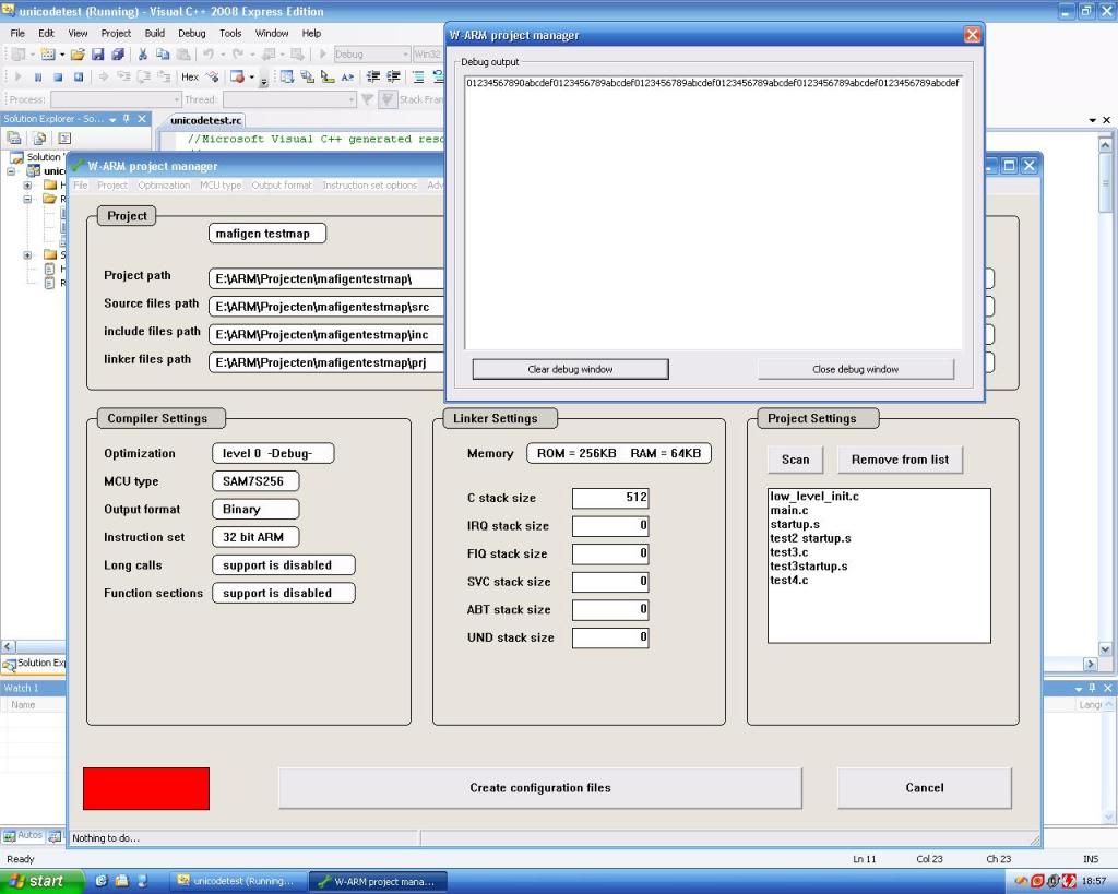

I ported my code completely to visual studio now from Borland. The same code without modifications now works under windows xp + SP3 when compiled under visual studio. The Borland 5.5 C++ builder works great, but the code it generates does not seem to function properly under windows xp +SP3. Which with hindsight can be expected since it is an old compiler and windows xp + SP3 has some new tricks.
I made my own printf version debug window from a modeless dialogbox together with a listbox control. All i do is send an HWND handle of the dialogbox and a pointer to a 0-terminated string and a small function does some parsing and there after sends the string to the listbox in the dialogbox.
http://i1006.photobucket.com/albums/af186/William_Gaatjes/screenshot3.jpg

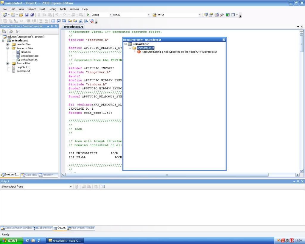

I also found the way to work with resource *.rc files.
While pressing on the *.rc file i would get this message :
http://i1006.photobucket.com/albums/af186/William_Gaatjes/screenshot2.jpg
But after some testing, i found out there is an easy way. Just press right mouse button and click "view code" . :awe:
Editing is now fully possible.
http://i1006.photobucket.com/albums/af186/William_Gaatjes/screenshot1.jpg
