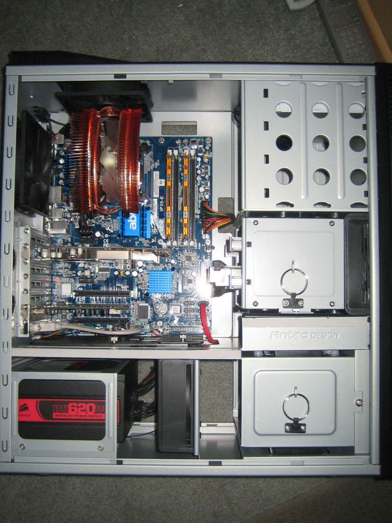

Here are some pics of my setup with the case:
Here is an overview of how it looks like with the cables all managed. I have a Corsair 620W PSU. I planned my cable routings out before I actually screwed down my motherboard. All front USB, audio, and the case wires are routed under the motherboard.

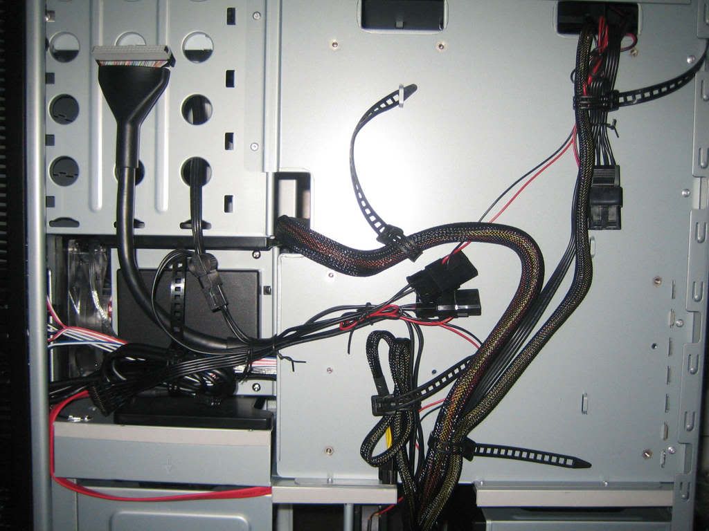

Here is a picture of the back of the case where all the cables are routed and hidden. You can see that I am using an IDE DVD-writer so I managed to squeeze the ribbon cable as well as the power molex into the circle holes to further hide the cables.
