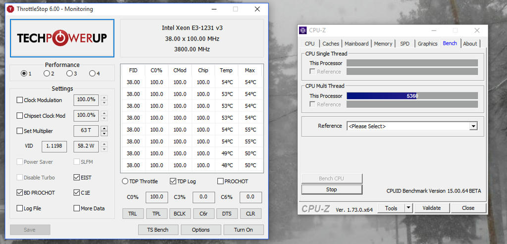

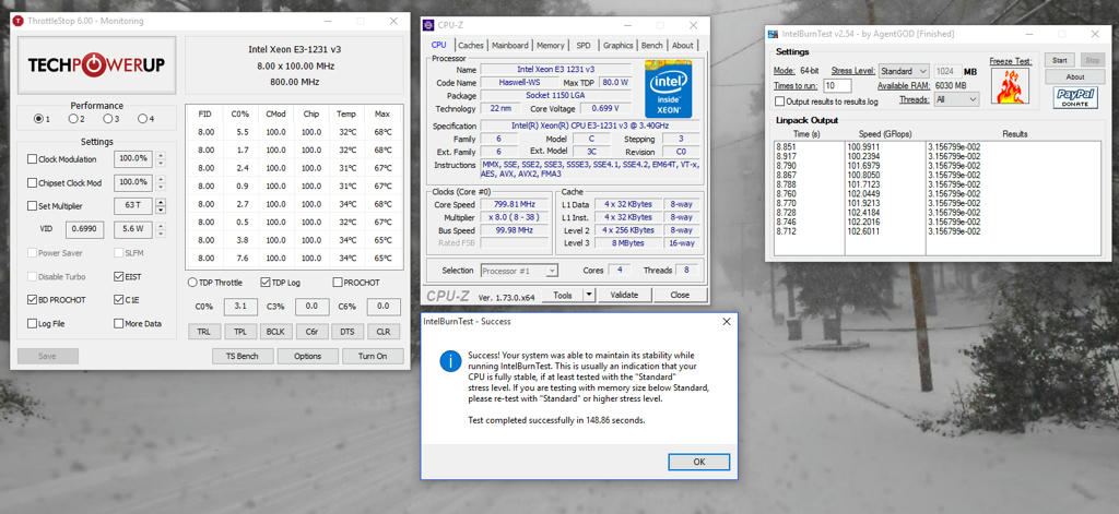

The ASUS Z97-A board has no problems. It runs the Xeon at 3.8 under full load. Just went to manual, sync all cores, set to 38. Reboot. And Bob's your uncle.
So far, so good.
Power set to balanced in Win10. Idles nice and cool. All four cores go to 3.8 when called.
Not seeing any TDP throttling with the Z97-A board and a Hyper 212Evo.
Runs like a champ! *
CPU-Z Stress:
Burn Test:
Passed Burn Test:
* After it took me 15 minutes to remember that the Xeon had no IGP...

In my pics post, you can see that the Xeon barely went past it's TDP number while running IBT with all 4 cores at the 3.8Ghz turbo speed. Temps stayed in the mid 60's.
So, I don't think it was much of a strain on the chip.
