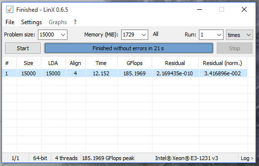

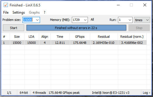

Getting 145 with 8 threads and 176 with 4 threads.
No throttling that I can detect so far. Your Bus speed is a little higher, and your ram is a little better.

Bumping the bus to 102/ram to 950, didn't increase the numbers much.
No way I'm getting anywhere near 200GF at 3.8Ghz with this Xeon.
I do have higher residual numbers, whatever that means.

Well, there's virtually no difference between our processors and ram, you have 2mb less cache, that's about it.
Their performance is going to be pretty much identical at the same clock speed, so it has to be other factors such as Windows version or background programs or something else.
LinX versions are the same, apparently, despite the different look of our screen caps.

That's pretty well in line with my Xeon score of 176GF at 3.8Ghz.
Don't know how the 4700MQ is doing so much better than us. :)

Well, we are only using 4 threads, and my Xeon and his 4700MQ are both Haswell 4C/8T chips running at approximately the same speeds.
My Xeon E3 1231 V3 is essentially an i7-4770 without the graphics.
I am maintaining 3.8Ghz forever, and I'm nowhere near his score of 200.
So there's something different between the benchmarks.
I should be defeating the 4700MQ in the benchmark, yet I am not even in the same ballpark.
