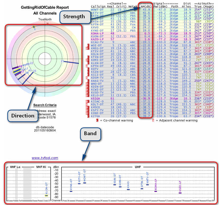

this on a pole on the roof would get a good number of stations in many environments: https://www.amazon.com/Channel-Mast...=UTF8&qid=1489094796&sr=8-1&keywords=cm3000hd Product Dimensions 2.4 x 12.5 x 15.2 inches
Should pick up stations (re: Antennaweb) that fall within CEA Color Code yellow, green, light-green (Multidirectional small/ medium/ large or small directional)
for example, at ground level antennaweb shows this for my zip code: http://www.antennaweb.org/Stations?...alse&Latitude=29.560052&Longitude=-98.3636131
at 30' elevation (typical rooftop/ high attic) antennaweb shows this: http://www.antennaweb.org/Stations?...True&Latitude=29.560052&Longitude=-98.3636131
tvfool reports are more technical, but they show the signal path (LOS is best, then 1edge, 2edge, and worst is tropo) <tvfool is down at this exact second, but see attached image for an example.

antennaweb.org mentions the color codes for antennae; tvfool is more technical with "LOS/ edge/ etc" and signal levels and does not mention antenna color codes.
(scroll to the bottom here: http://www.antennaweb.org/Info/AntennaInfo )
this antenna says it is CEA Color Code yellow, green, light-green https://www.channelmaster.com/SMARTenna_HD_Antenna_p/cm-3000hd.htm
