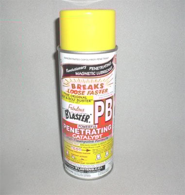

It's better than the "panther piss" smelling stuff that I use for penetrating oil...
(and that's not the worst smelling penetrating oil I've ever used)
Panther piss - never heard of that one before. 😀
Usually the one that's tossed around here is weasel piss. D:
