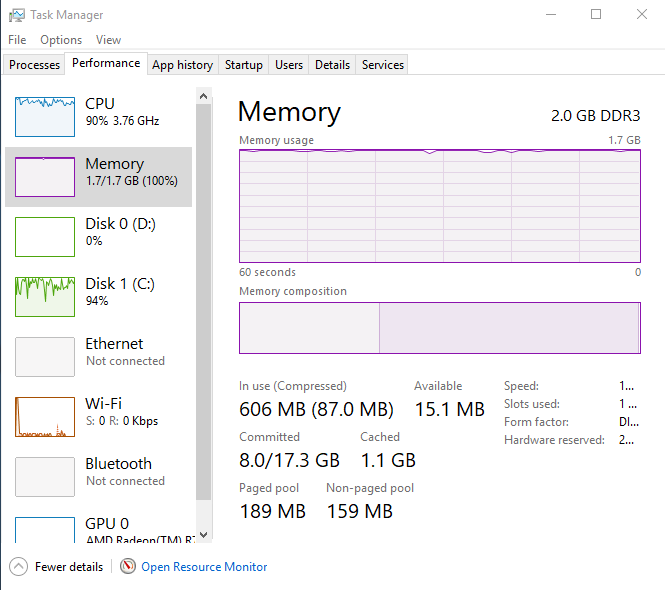

Here is a typical task manager screenshot for Browsing with Firefox using 2GB RAM, 800p, Windows 10 Pro:
Browsing performance is still very good at this level of page out....I attribute this to having enough free DRAM available for writes.

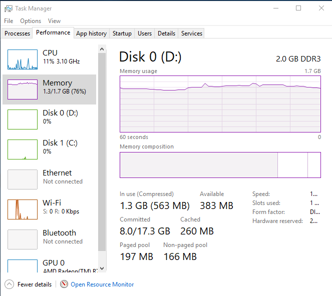

However, If I go quickly (ie, open tabs very fast) to 8.0 GB commit charge here is what happens to the available DRAM:
Performance at this level is very slow.
......but this does improve as the CPU settles down and some DRAM simultaneously gets freed up:
