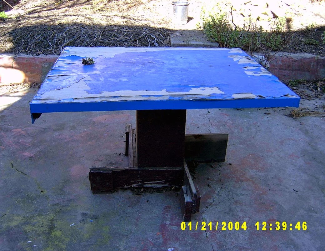

The table before renovation, 2004:
Pre-renovation:

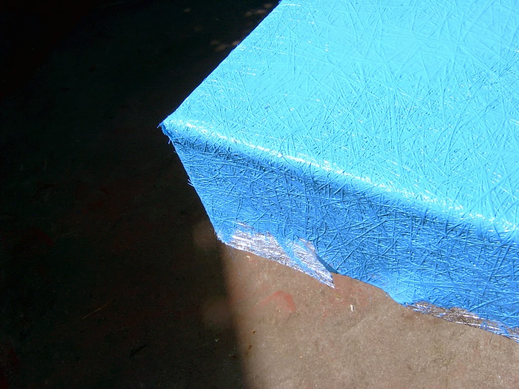

Closeup of fiberglassed corner before applying finish coat:
P-BAXhwRiQvBkde-4Cza07gkMSVBUMA20yTLuIUiBPA=w1071-h803-no
