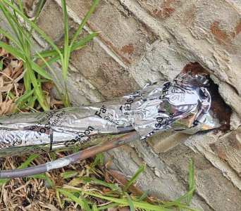

I just replaced the insulation on the pipe that runs from my a/c unit into the house...
Is it okay to shoot that foam where it runs into the brick? Or is there a better method to do this?

Were it me, I'd just mix up some thick sanded grout and fill the outside of the hole in the wall around the line (just where it goes into the house from the outside) and call it a day. Easy to remove in the future by chipping it out with a screwdriver if the copper line ever has to be re-run for any reason.
And, if I wanted to get really fancy, I'd create a 2 piece color matched brick fascia cover with a hole in the middle the size of the copper line passing through and use either the grout to attach it to the brick or by mounting the plate to the brick with a couple of thin masonry tapcon screws.
