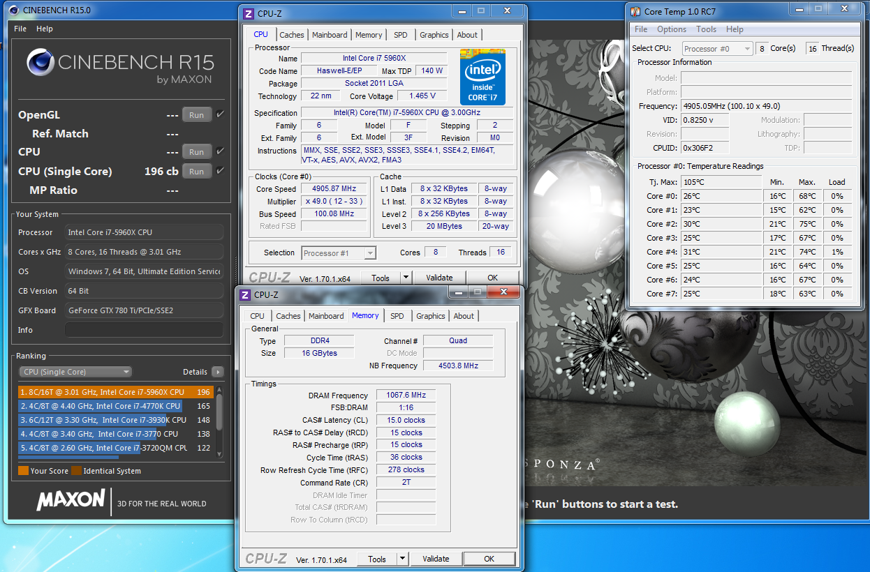

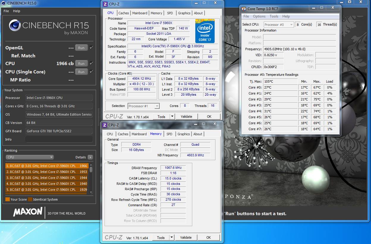

I would not use Prime, Linx, IBT etc for stability testing on X99, use AIDA, Realbench, x264 and Games like BF4 etc.
Single thread and a 4.9 GHz multi.
Trying to hit 2000CB but it's hard with this memory, the CPU drags it around like an anchor.
Edit: I'm keeping the water temp at 16 C now as I'm pushing vcore pretty hard. All voltages I use here are for short benches only and at my own risk :)
