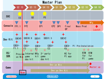

What does surprise me is it sounds like Nintendo basically rushed Switch development.
Yes
Contract for Tegra X1 and Nvidia being the SoC supplier was accorded around 2014 and console finals specs were finalized in Q2 2015 (ES). The only change the console specs went from was the Storage which was increased from 16GB to 32GB for the retail unit launch.

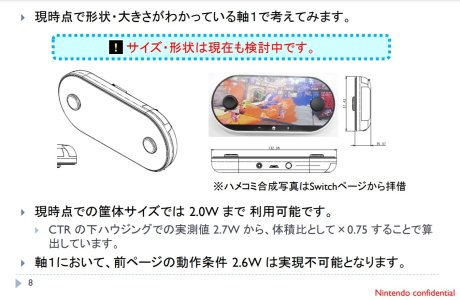

BTW these were the specs for the Switch before Nvidia was the chosen SoC supplier:
4x Cortex A53
AMD Latte Decaf (AMD Latte 1/2)
1GB LPDDR3
Toronto SoC for 3DS BC
Miracast for Wireless Streaming from console to TV
853 x 480 Dual 3D Screens / Single Screen (with 120Hz option) (The screen spec kept changing throughout the development)
Target Power for SoC: 2W - 2.6W
