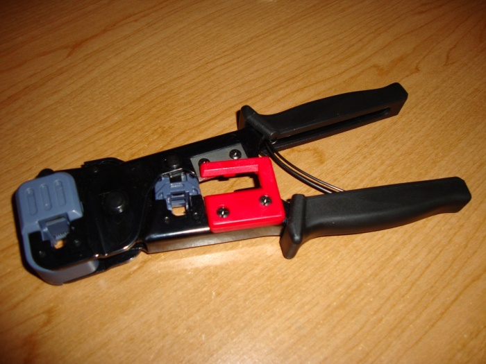

You probably didn't get the right pressure on the crimp, what crimper are you using?
But IMO I wouldn't even bother, just buy patch cables and know that they will work.

It's going to a jack, the jack works fine at 1gbps with a cat5e cable I made a while back. I did wire the jack too though. I'm using this crimper. (not sure of brand, bought it long time ago and it does not say anything on it).
