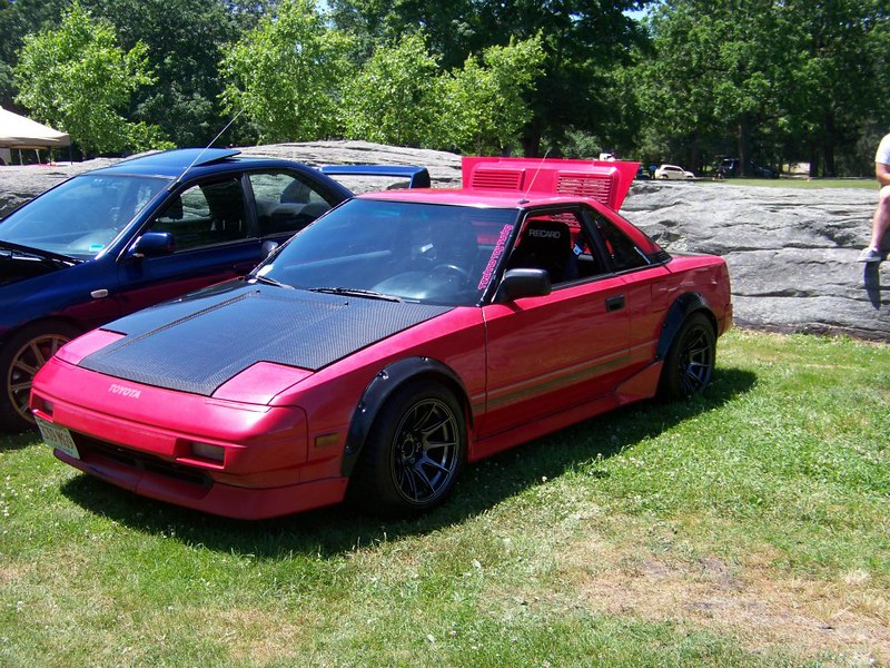

That black car above has stretched tires on it... not really a great look IMO. I also do not want to put flares on my car. I prefer the stock look, but I cannot deny that there are some AWESOME looking MR2's with flares.
The red car above appears to have the Enkie RPF1's but is also lowered about 2".
Max coolness is achieved by this guy IMO. Body kit not available in North America unless you have lots of $$$$$ and speak fluent german
