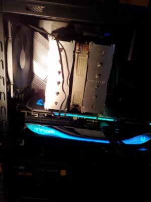

the GPU fans don't spin because the card isn't working hard enough to need to spin. all modern GPUs act like this with zero RPM fan modes, which is baked into the GPU fan controller firmware and again not the root cause of your issue. it's only a symptom. the fan error itself is not causing any problems, nvidia-smi is just having problems communicating with the GPU.
But windows does not even see the card, and linux nvidia-smi reports an error trying to read fan rpm. The card is bad.

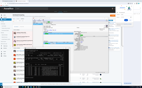

Good points ! My next test is to put it in a 7950x motherboard/cpu combo that has run a 2080TI just fine and has all the drivers. I am sure its PCIE V4. I hope it works !

From which computer is this screenshot?

Screenshot of 7950x-6 system. Its an MSI motherboard. I can't find the model in my purchase history. But here is a pic :

Edir: The problem was that the motherboard was NOT PCIE V4. It works in a 7950x board.
