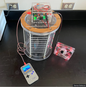

Most of this is well-understood. It appears to start with a dehumidifier to get water out of the air. (There are a few methods, thermal or chemical; I'm not sure which they use.) Then I expect they'd use electrolysis to extract hydrogen from the water. Finally, I expect they'd use the Fischer-Tropsch process to turn it into gasoline.
The missing part of this is extracting the other ingredient in Fischer-Tropsch, CO2, from air. How it works, I don't know. Does it integrate with the dehumidifier?
You're right about energy storage, wrong about the method. Hydrogen is easier to make than methane, and a fuel cell is more efficient than burning. Other common storage methods are batteries and pumping a working fluid, usually water or air.
But this tech might allow large solar installations away from the grid to make fuel instead of grid electricity. Cost would be key. I think it would be hard to get gasoline under $4/gallon; I seem to recall an estimate of $10/gallon.
Hydrogen, however, requires compression and refrigeration to store whereas gasoline doesnt. Even then, hydrogen is still difficult to store , because it tends to more readily leak from hoses, pipe fittings, due to its small molecular size. It seems theres always tradeoffs.

I'm not seeing much info here, so doing a little napkin math at the end of the day. Please obliterate my argument 90s internet style if you're in the mood:
The "octane" from "octane rating" is iso-octane which is 2,2,4-Trimethylpentane or C8H18, which has an enthalpy of formation of -258KJ per mole. They say up to 10kg CO2 per day, which is 227.25 moles, which means if carbon is our limiting reagent, we can get 227.25/8 = 28.4 moles of iso-octane. We'd need 9/8 = 1.25 times as much hydrogen as carbon, so 255.66 moles of hydrogen gas. To get this we'd presumably have to get it from water. To break water into O and H2 costs 285.3 KJ/mole.
The energy to break CO2 into C and O2 is 393.5 KJ/mol, which in a perfect world means to break apart the CO2 we'd need:
Code:
(227.25 mol * 393.5 KJ/mol) = 24.8396875 kilowatt hours
To dehumidify the water with its latent heat of vaporization at 44KJ/mol :
Code:
(255.66 mol * 44 KJ/mol) = 3.12473333 kilowatt hours
To break the water:
Code:
(255.66 mol * 285.3 KJ/mol) = 20.261055 kilowatt hours
and to form the iso-octane we'd generate:
Code:
(28.4 moles * -258 KJ/mol) = -2.03533333 kilowatt hours
So in a super-perfect world, to turn CO2 and moist air into just iso-octane we'd need:
Code:
24.8396875 + 3.12473333 + 20.261055 = 48.22547583 kWH
48.23 kWh. A 400W Silfab solar panel weighs 47 pounds and has an area of 21.4 square feet (https://www.solarelectricsupply.com/silfab-sil-400-hc-plus-400w-solar-panel), which will give about 2kWh per day, so we'd need 25 of them which would be 1,175 pounds and take up 535 square feet. They seem to be around $300 each, so you're looking at $7,500 for the panels alone. Call it $10,000 for the power package.
Of course... the real world isn't ideal. You need to capture the CO2 which is about 65KJ/mole in an ideal situation, which more than doubles our power usage, so maybe $20,000 for the power package and 1100 square feet of roof. Then you need to add in the actual moving parts to do this, the structure, the installation, the transport, the profit, etc. Neat. Maybe $75K per unit? You'd also presumably have to treat the iso-octane to make it usable and you'd get... 4.69 liters.
Let's say you cut that for free down to 87 octane. You'd get 5.4 liters of gasoline per day. At $4/gallon you'd get $5.70 worth of gasoline per day. That's 13,166 days to break even in our fairy tale world. Double neat.
