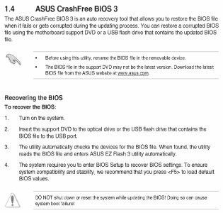

I'm wondering if an ESD event scrambled the bios, and would try this:
(sorry for the pic, the silly Asus PDF text won't copy/paste)
AFAIK the flash drive needs to be a single partition, FAT32. Might also need to be USB port #1, whichever that is.
I'm just assuming your board doesn't have a dual bios, or if it does, then I wonder why it isn't automagically reverting to the 2nd bios or if there might be something in the owner's manual about that.
Whike I try to discharge myself of static electricity before doing anything, I can't guarantee I didn't fry anything.
Where did you find that picture from? It's not in my board manual. As far as I'm aware the b450m-a doesn't support bios flashback.
The pic is a screenshot of "BIOS_Update_Manual_(English)" page 7:
Found on this page:
Page 5 on the same bios update manual, mentions flash drive should be fat32/16 format and single partition.
