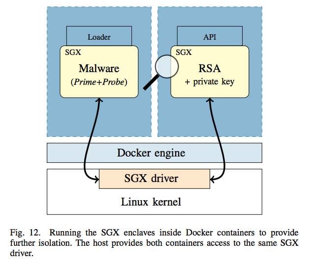

Weiser and his team created a side-channel attack they call “Prime+Probe”, and say it works in a native Intel environment, or across Docker containers.
The PoC is specifically designed to recover RSA keys in someone else's enclave in a complex three-step process: first, discovering the location of the victim's cache sets; second, watch the cache sets when the victim triggers an RSA signature computation; and finally, extracting the key.
As the paper puts it:
We developed the most accurate timing measurement technique currently known for Intel CPUs, perfectly tailored to the hardware. We combined DRAM and cache side channels, to build a novel approach that recovers physical address bits without assumptions on the page size. We attack the RSA implementation of mbedTLS that is used for instance in OpenVPN. The attack succeeds despite protection against sidechannel attacks using a constant-time multiplication primitive. We extract 96 % of a 4096-bit RSA private key from a single Prime+Probe trace and achieve full key recovery from only 11 traces within 5 minutes.
The attack even works across different Docker containers, because the Docker engine calls to the same SGX driver for both containers.
Docker containers share the same SGX driver
