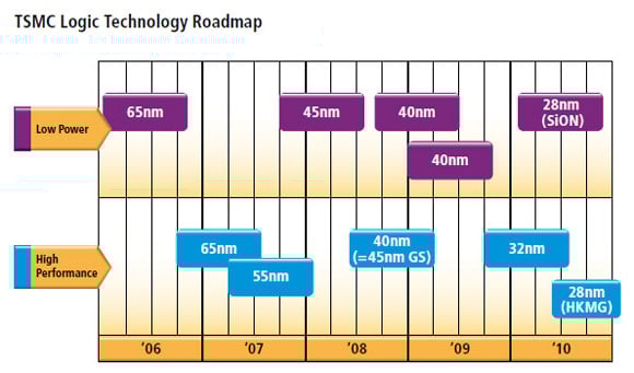

ShintaiDK
Apr 22, 2012
20,378
I will just leave this :p

Here's the cause of the big if. GLF screwed 32nm SOI, then screwed 28nm bulk and according to the info you brought here they screwed 20nm bulk too. Their track record does not show the bare minimum execution capacity, they are the AMD of the foundry world, always hyping, always delivering less than it should. Also remember that a very cash strapped company decided to pay a hell of a money to get out of a contract with them, something they wouldn't do if they were assured of their capacity of execute the proposed road map.
Yup, it's always a possibility that we won't see a repeat of their track record with the 14XM process... but I'm not going to believe it 'til they have actual products rolling through the fabs in mass production. They're just now getting 28nm under control and want us to believe that they're going to have 14nm finfets in 2 years? It's not impossible, but it certainly does sound like it's something that they just finished cooking up in their labs and are now running it through the fabs to see if it actually translates to mass production - note the fact that when asked about the status they simply stated that test silicon is running through their fab without mention of whether or not it's looking good.
