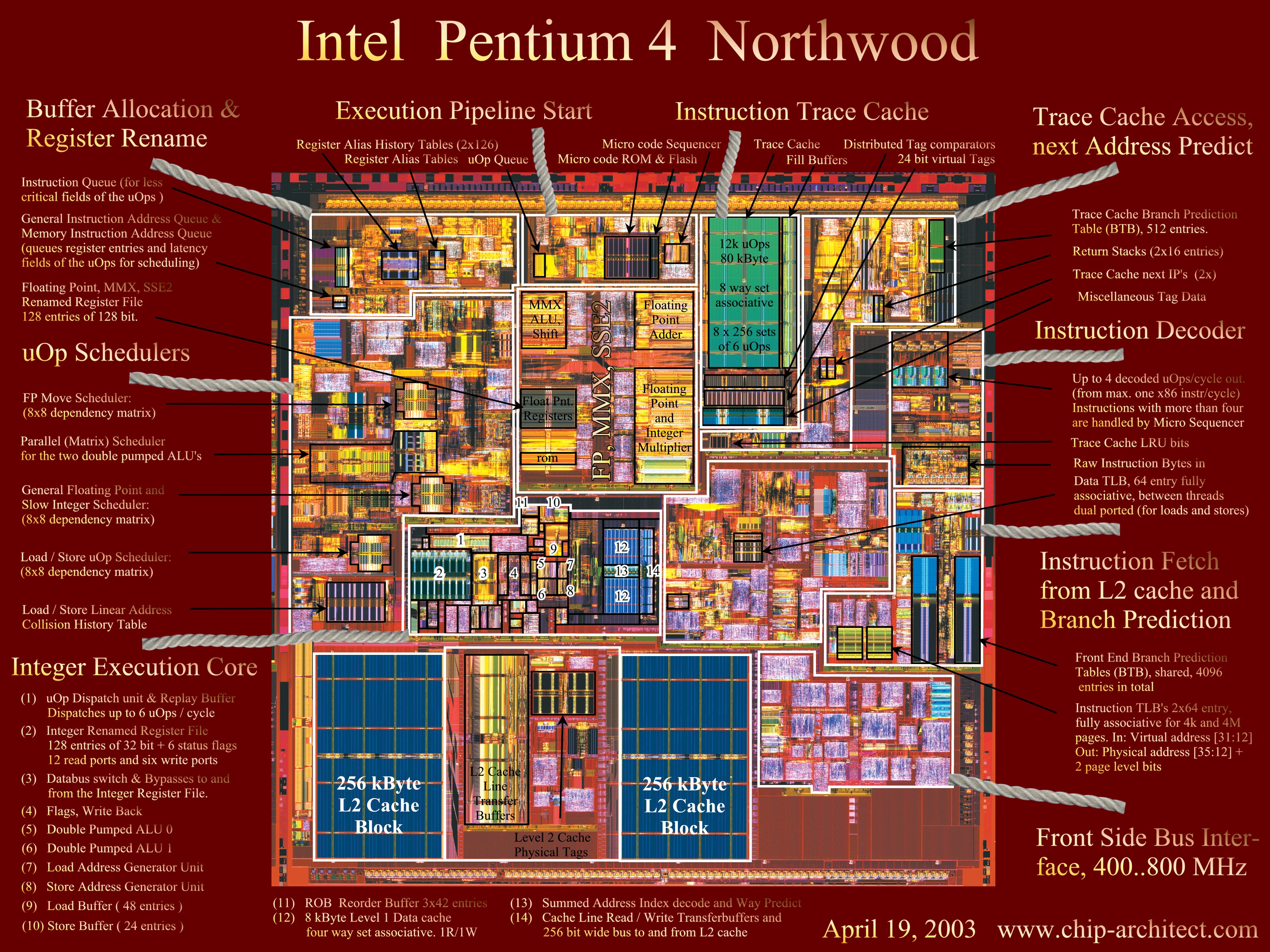

You can look at the die and see the relative sizes of the different parts to some extent. Also it should be noted that transistors sizes also have a big play when you start talking about adding memory controllers and stuff, the big amplifiers and ESD diodes for all those extra pads are take alot more area than the number of transistors might suggest.
Here is one persons take on the layout which may or may not be correct.
Based on the information in these other places though it seems to be incorrect, what it labels as the shared L3 would seem to be the shared L2 and what it has as the L2 would appear to simply be the tags for each cache block, but then again none of other really knows so its all speculation.
on the whole scale of things, those items are insignificant.
well he got the cache sizes right but not the right location. anyways, nemesis should recalculate with the correct cache sizes
Just BTW that same site has some other pretty sweet diagrams for those interested
Maybe Nemesis 1 should check out his favourite sexy P4C
