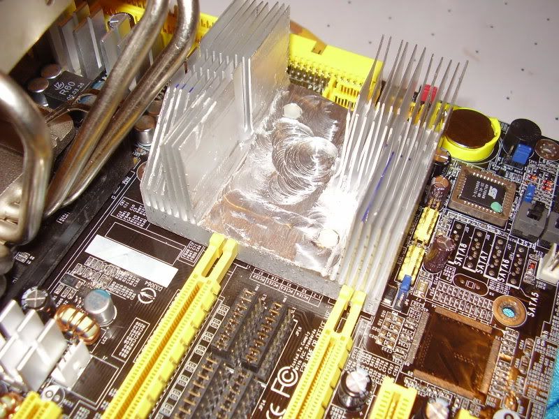

Originally posted by: twitchee2
I made my own with a stock a64 HS. pics here.
Zepper did something similar in his son's system, fitting a custom mount to an Arctic Cooling Freezer Pro and cutting a slot down the middle between the heatpipes.

twitchee2
Dec 29, 2004
2,135
thats where i got the idea.
