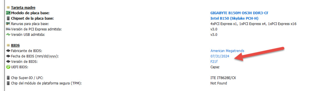

- BIOS Version: The last
- Current Status: The modules work fine in pairs (16GB), but not all four together (32GB).
