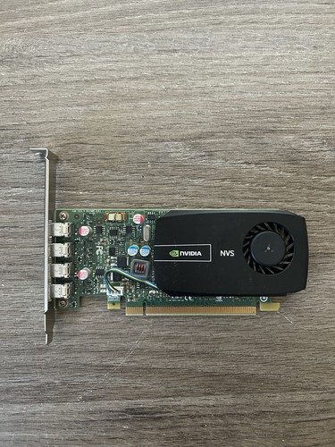

I'd look at grabbing a couple Nvidia NVS 510's. They're basically free at this point. single slot and you could run 8 DP off of them. Not sure where you're located, but there's a ton on eBay or if you have a local electronics recycler that parts them out of old workstations.
