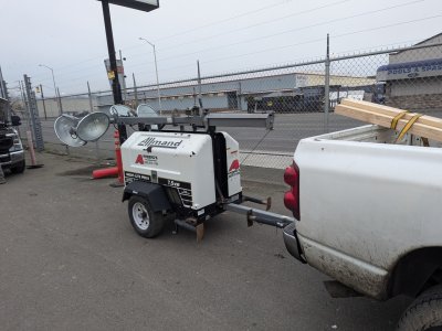

I purchased this late last year to complete the home build and I will not let it go.
It has the Kubota 3 cylinder diesel. Pancake 8 KW power head and the combo is rated at 7.5Kw.

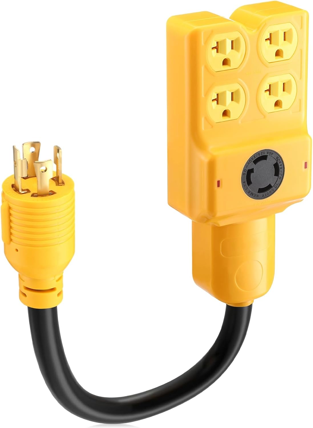

L14-30P NEMA twist lock on a 35 amp main breaker.
A pair of 6-20 on a 20. I won't jack this into my panel. Too much monkey motion already with the inverter and critical loads.
I have this breakout plug and 100 and 50 of cords for it.

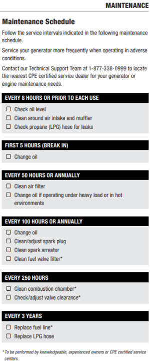

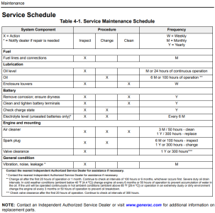

Wish that worked for me. I have two engines (Ariens snow blower and no-name pressure washer) that both gum up even when running to empty at the end of each use. I've tried everything under the sun and they still won't start the next season until the carburetor is removed and cleaned. Small engines and I just don't get along well.
Then you have the oil changes, filters, spark plugs, weekly cleaning of louvers, corrosion removal, electrolyte replacement (depending on model), monthly vibration/noise/leakage checks. All easy stuff to do and many people just skip maintenance. But I just didn't want the cost and trouble.

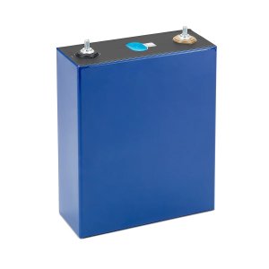

I have Lithium Iron Phosphate batteries for my solar storage. They are used everyday to provide power to my house when the solar isn't sufficient. I just let the BMS manage them. The cycle life is supposed to be about 5,000-6,000 cycles so I am good for a long time.
The batteries are essentially a bunch of these which are 3.2V 280 Ah LFP Batteries. You put 16 of these together in series and you have a 48V battery that can be used for Storage to power a house. They are all housed in a metal tower that is UL fire rated.
