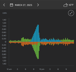

The installers wrapped up the install just a couple of days ago. I don't have the interconnect approval from the electrical utility yet but the panels are working. It's a 6.4kw system with 10kw of batteries which appears to enough to last through the night if there's enough sun to charge the batteries to 100% during the day (Though probably not enough to cover overnight use during Nov-Feb months).
Green: Battery discharge/charge rate
Blue: Solar generation
Orange: Electrical consumption
Gray: Imported from electrical utility
You can tell when it got real cloudy just before noon when my solar production tanked. It was a lighter use day because were were at a friends house for most of the day

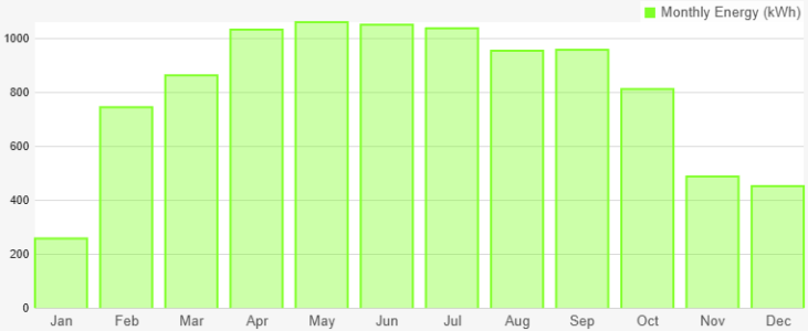

Nice! I have a very similarly sized set of solar panels (6.85 kW) facing directly south in the midwest, 12 kWhr of battery backup, and an EV on its way. Ask if you have any questions.
Here was my solar generation in 2024. January was terrible due to ice buildup for 12 days. But this January I produced nearly triple the amount shown on this graph.
