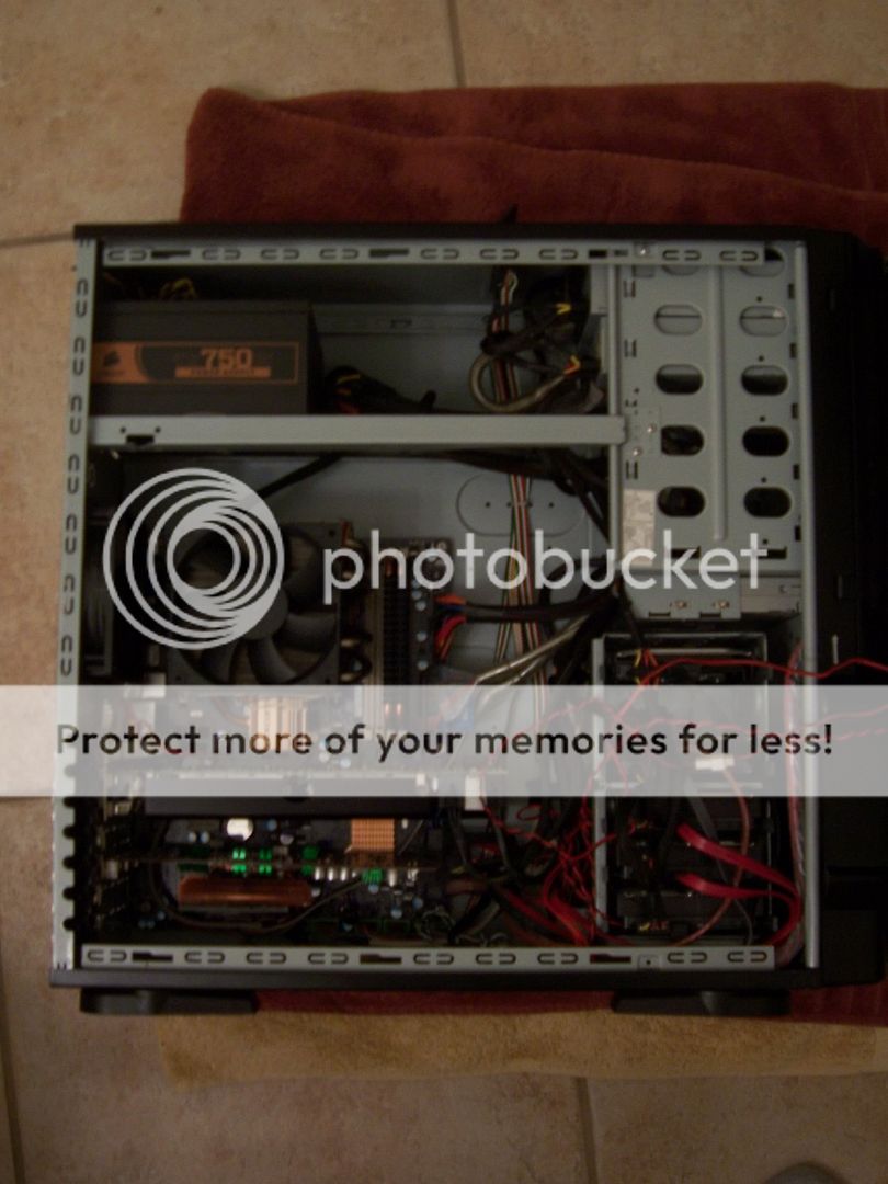

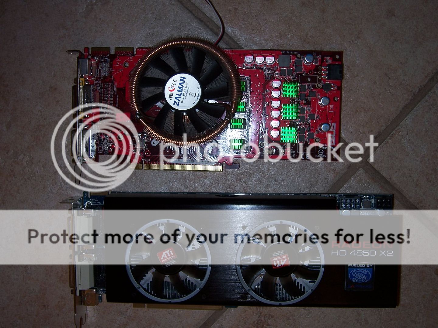

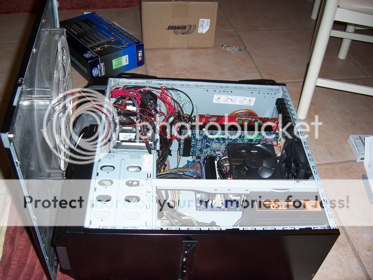

My pearly 940X4 and a 4850X2 + 4850
Interesting results. Not too surprised though, 4850x2 has shown to edge out 4870x2 in certain high-res, high-memory situations (especially at your res and AA levels). Good luck with your setup, definitely looks killer.

Thanks, I appreciate it. O yeah, by 4850X2 you meant 4850X3, right?
