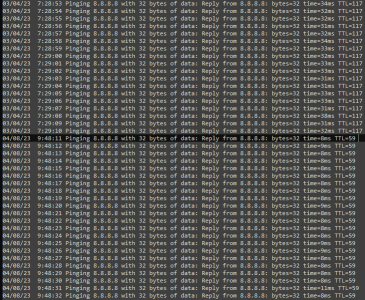

They do work well. I just swapped one into my new mobo for my current project to go all flash for data / NAS. Was a bit of a PITA from what I was figuring because they enveloped the M2 into a metal housing that dropped into a vertical socket key-E vs using a normal socket horizontally. To add insult they also glued the antenna cover to the card making it even worse trying to pull it apart. Got it apart but broke the connector off the card for one antenna off the OEM version it shipped with. Goof thing I get these cards at a good price or I'd be a bit pissed if I end up needing to send the board back later.
The secret though to these 411's is being able to bundle both bands into a single pipe for more bandwidth. 8ms though is pretty good for a ping to google. I don't even recall what my normal ping would be to them since I've been running a VPN for years now and that just adds latency to the mix.
Yes I was really surprised with the google ping improvement. I am using CloudFlare as it was always faster. Previously was pinging them at 10-14ms now its pretty much the same 8ms as i get with google.
yea the installation of the antennas was a bit tricky. when I got the card and antennas out I couldn't even figure out where and how to attach them. My failing eyesight wasn't helping. Had to watch a few videos to figure it out and then only one antenna snapped into place, the other I wasn't even sure it did snap into place, NO click.
how to do that? Can U just point me in the right direction...
ahhhh.... dont worry about it just figured out it will do nothing for me wanting to improve the ping.
