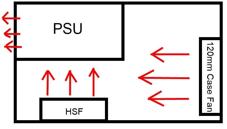

Here's a simple diagram of the airflow in the case:
The front 120mm fan is a Silverstone Air Penetrator:
http://www.silverstonetek.com/product.php?pid=257&area=
The fan cools the motherboard and components in the case. The SFX PSU has an 80mm fan which is sitting above the CPU, drawing hot air in and out the back of the case. The heatsink fan on the Slim X3 is 92mm and is blowing air up at the 80mm PSU fan instead of down onto the CPU. I did it that way so the PSU and heatsink fans don't fight for air.

If I use the NT06-Pro. on my board AND put a 120mm fan on the NT06-Pro. will such a large fan on the NT06-Pro. starve the PSU's fan of air if I have the 120mm fan on the NT06-Pro. blowing down onto the CPU / motherboard?
Here's the diagram again of the current airflow in the case (using the Thermaltake Slim X3 heatsink w/ 92mm fan):
1412890
The top of the NT06-Pro. would be right up against the underside of the PSU / its 80mm fan. The 120mm fan mounts to the underside of the NT06-Pro.'s fins.
1412890
Just the opposite , if the PS is exhausting out of case and your HS fan pushes up to two will help evacuate the case .
For sure you don't want then working against each other (HS fan blowing down) .
I would run a fan with HS, though you might be able to get away with just PS fan passing enough air as it is so close to the HS .
I would try it with and without fan on HS if you rather not have fan . Just test it good under load to make sure temps are not bad, it is small case , they tend to run hotter .
Edit: I should read slower, you don't want HS fan blowing down in this case, that would be bad IMO .
So if I put a fan on the NT06-Pro. in this case, the fan should be blowing up into the PSU, right?
Yes, and remember to the intake fan and vents on side will help, even though the fan is pointing up your MB will still get airflow past it as the air has to get into the intake side of fan . It maybe not as much airflow over MB as fan down but with that case your not going to get good results that way .
Well you could try it but don't think out come would be good . I would go fan blowing up .
