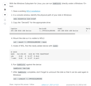

How to run badblocks in Windows? https://superuser.com/questions/338067/equivalent-of-badblocks-on-windows-or-dos
