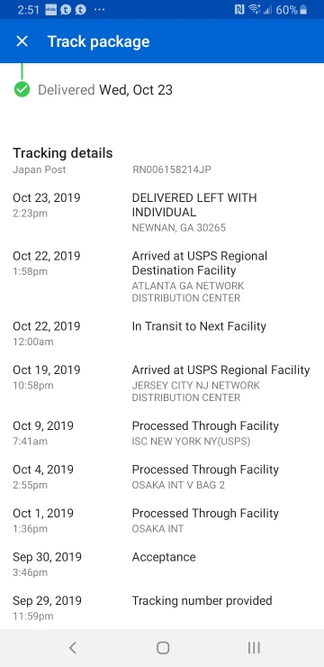

Another update finally about my pi2jamma. After sitting in the Failicy ISC New York (no clue wtf that is) since October 4th, it's now at a processing center in Queens, NY and says it's in transit to the destination.
I don't order much from overseas, but I ordered this item on October 20th and didn't know it would take THIS long to get here.
EDIT:
Apparently waiting at the ISC facility for days is common.
EDIT:
Indeed. My copy of Akumajou Dracula X Chi no Rondo (Castlevania Dracula X Rondo of Blood) for PC Engine Super CD-ROM² sat there for 10 straight days recently.
EDIT:
Customs can be a roller coaster. I've had things blow through in a day, others take a week+. As far as I've seen, no rhyme or reason to it.
