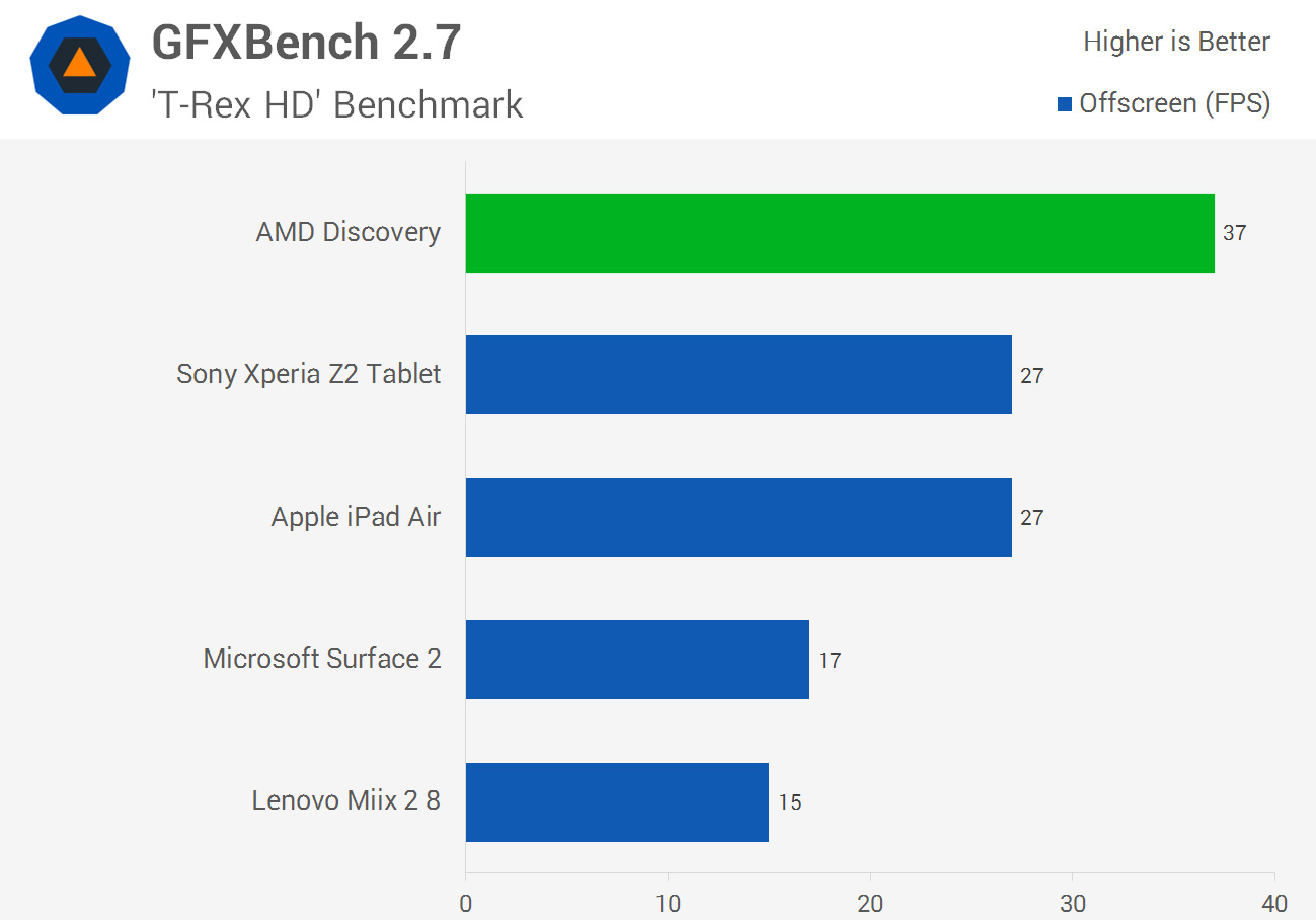

Seems like I was almost spot on with my early 2014 prediction. Again, if NVIDIA's claims hold true (60 FPS @ GFXBench 2.7) then K1 should have a confortable lead.
Fun fact - Mullins (AMD's next x86 tablet chip) scores 570 @ 3DMark11 according to AMD, thats a slightly lower score than Kabini A4-5000 (~590 pts). If Tegra K1 really does 60 FPS @ GFXBench 2.7 then it will outclass AMD's solution big time in the graphics department, Mullins should score around 35-36 FPS based on AnandTech's Kabini results.
