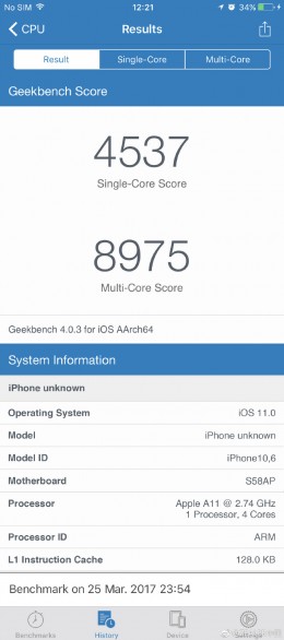

And now with the news... I forgot someone important... Apple... they are showing up in Geekbench this:
Source: http://www.gsmarena.com/iphone_8_allegedly_runs_geekbench_destroys_the_competition-news-24728.php
Apple literally murdered ARM and is near X86 tiers.

138
The likelihood of this being a fake is *very* high. At least please don't pretend it's a "news".
Considering the current Apple chip development... It might be not that fake at all.
Even more, it would be dissapointing that improvement.
After making some computations you are indeed correct that this might be possible. My apologies :)
That'd represent a ~17% IPC improvement over A10. I still find the frequency increase way too high, but we'll see.
11,715
2,012
That score is about 30% better than the A10, easily within the range of typical yoy perf increases for Apple. Only "dud" in recent memory from a CPU perf improvement perspective I can think of is the A8, but that's because 20nm was poor and Apple missed their frequency targets.
Indeed, it might look fake BTW. However it could be realistic increase from Apple. But... Seems that they are on the limits of Dual Core. Seems that is the time to use one of the two:
- Use the full Quad Core design (that means that the next iteration will be downclocked but the new clocks will be for all of them)
- Use SMT on the big cores for better efficiency
Nothingness
Jul 3, 2013
2,222
495
I wonder if the MT score doesn't point to either of these two improvements: it's low for 4 big cores.
