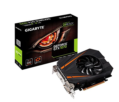

Thanks for the suggestion. This definitely ticks most of my boxes. Even if I switch it to an ncase m1 would still keep it around my $1,250 budget. Of course, I'll have to check compatibility on the cooler but that's not a significant cost. I've heard about the Gigabyte card and it's definitely cheaper than the others. Are there any issues with it thermal throttling due to the reduced heatsink?
Not sure, but any potential throttling could also be affected by ventilation with the case as well.
