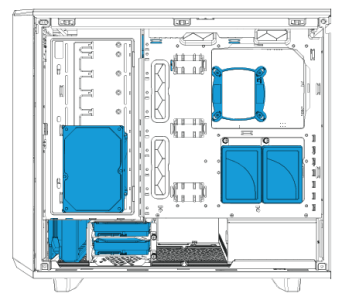

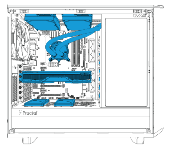

Have you looked at the manual? There are some diagrams of various installation locations:
Looks like you can install 2 in the HDD cage in the PSU chamber, 1 on a bracket above the HDD cage on the back. In order to save as much room as possible for GPU you can mount a HDD on the inside top, where you would typically mount an exhaust fan.
Also, the specs show that max GPU length is:
  • GPU max length
    Open layout: 470 mm (445 mm w/ front fan) - Storage layout: 290 mm
You can use PC Partpicker and filter the cases by # of internal 3.5" drives bays, but that doesn't tell you the whole story as you've found out. It can help to look at finished builds in that case though and see where you can fit certain things.

You remove the side panel then an access panel to get to the internals of the basement.
See Fractal Design's video:
