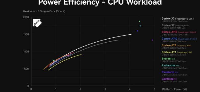

Screenshot_20231012_062255_YouTube.jpgThis is a very interesting diagram.
In the mid-range, At the same power- Cortex X3 is not that much more efficient than A715. And at low-range A715 is more efficient.
So
X3@4W = 1500 points.
A715@2W = 1000 points
[Rounded off numbers].
If we assume linear scaling for multi core performance from the single core scores;
Let's say we need to achieve 3000 points in multi core performance.
We'll need
2 × X3 = 3000 points @8W
3 × A715 = 3000 points @6W
__
So the A7xx cores are still the best way to scale multi-core performance ig.

View attachment 87064This is a very interesting diagram.
So
We'll need
__
That is a somewhat dubious conclusion. If you don't care about the extra die size of the X3 cores, they are clearly much more efficient in multithreaded loads. CPU performance is not linear with power (frequency), so to achieve *at least* 3000 points a better comparison would be:
3 x A715 = 3000 points @ 6W
3 x X3 = 3300 points @ 6W
In terms of performance / W, the X3 is clearly substantially better once you get above ~ 1.5 W package power.
That does not mean the X3 would be the best option in all scenarios. Not only does it take up more area, it also likely uses more power at lower utilization rates. That will not show up in benchmarks, but if you imagined a SoC that had only X3 cores, the practical battery life would likely be very poor compared to one that *also* had cores with lower absolute power usage.
In other words, if your intent is to make a server chip, X3s would be the way to go. If your target is a phone, however, X3s might win benchmarks in performance / watt, but actual battery life would suffer.

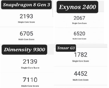

The Tensor is getting absolutely buried here. Funny, it feels out of place. Slower than previous gen Snapdragon 8 gen 2 in both single/multi scores
Doug S
Feb 8, 2020
3,835
6,777
Google is going to have sell pretty heavily on "AI" to make consumers overlook how it will be behind every other Android phone (at similar prices) performance wise.

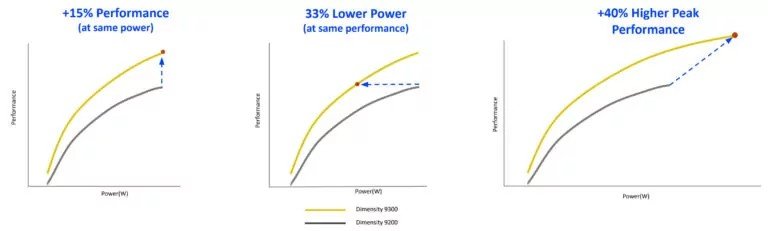

This is what is the most interesting for me. I can see that Mediatek is not after the MT Performance Crown, that's more of an effect of their strategy. They are going for the 33% Lower Power at same performance (Theoretically, the X4 at mid-speed are more efficient than the A720 at peak performance).
Looking to how it compared to Qualcomm's implementation, relying on the A720s, to see if the extra cost (Both in licenses and in manufacturing) are going to be worth it for Mediatek.
