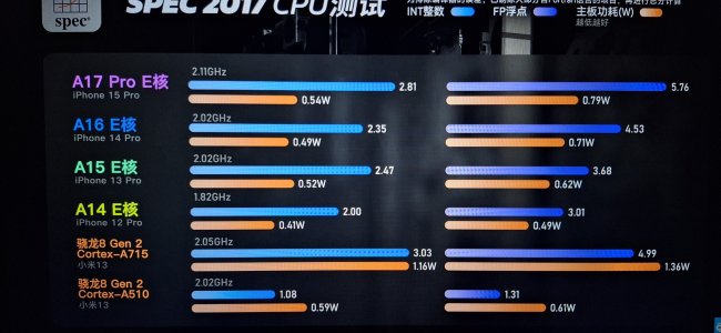

Also Apple E cores use way less power, A720 need to be 300-500% more efficient to be used like Bionic Configuration
Going by this chart A15E is significantly less than 300% more efficient (243%?) than the D1200's mid A78 despite A15 being fabbed on a significantly better process node (N5P vs N6).
Obviously this chart is not a great representation of the current intrinsic µArch efficiencies given that this is at least 1-2 gens out of date on both sides and not iso process.
Would be nice to see A715 vs A16E on a similar process node.
Wait, so is Apple E even more performance than Cortex A7xx?
More perf/watt, but not more raw perf - not even close going by A78/A15E.
Though gains from A710 -> A720 have been smol for 3 generations, A720 is only just catching up to X1 now in the X4 generation.
So A17E could very well have met or exceeded A7xx perf at this point.

Hmmm, now that I look at this graph further I see the S865 A77 Prime has an even better efficiency than the D1200 mid A78.
N7P S865 = 6,658J % 3.59 Spec points = 1,854J / Spec point.
Then account for the 0.661111x power node difference between S865's N7P and A15's N5P: 0.661111 x 6,658J = 4,401J.
Node normalised perf/watt:
S865 A77 = 4,401J % 3.59 Spec points = 1,226 J / Spec point.
A15E = 2,349J % 2.42 Spec points = 970J / Spec point.
A15E still ahead by a good margin, but not nearly so bad as 300-500%.
My math on this may be entirely wrong so please explain my mistakes if so 😅
Edit: I know that process node gain figures are idealised, but it's all I have to work with.
