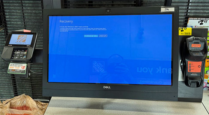

Recovery BSOD
Figure 1. A checkout station at Home Depot in Recovery modeSource: @ErrataRob. Used with permission.
If it’s at your local Home Depot, it’s safe to assume the problem is extremely widespread, much more so than the mainstream reporting that focused on airlines and banks.
