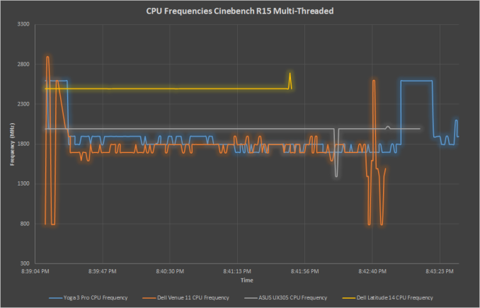

It depends a lot on the design. One of the best designs in the Surface and Asus also got one. A bad designed m7 may perform like a good designed m3.

Yup, all depends on how the tablet is cooled- and how the BIOS is configured.
For example my Dell Venue 11 has an i5-4300Y. Dell have configured a 6W long-power limit, so after ~20 seconds of a gaming load it throttles, hard. An i3 in a better-cooled tablet with higher power limit would no doubt perform much better.

However one question. In the Anand article about the m3 Asus and m7 Dell/Lenovo, it seemed like the aluminum housing of the Asus is a huge advantage. So, in other words, thermals at work.
