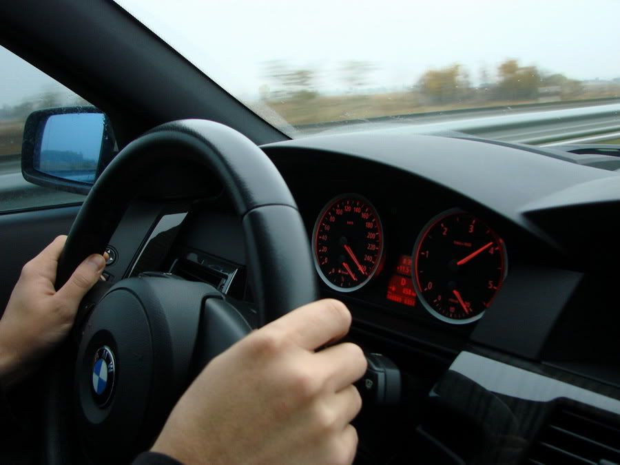

Oiprocs, if you want better mileage why don't you get a nice diesel? On the highway my 535d cruises at 100mph and averages 30mpg. RPM is about 2500rpm.
With my engine I can probably get 40mpg at 70mph.
Smaller engines (2.5L diesel) have 190hp and will get you 45mpg at 70mph.
A diesel will get you high speed with low RPM. Check the picture below, my 535d at top speed and still under 4000rpm.
pic

Holy sh!t. That's nuts. I can't stop staring at your speedometer. It's like, yearning to go farther.
I would love to get a diesel, but I can't afford to purchase a new car. I've tried searching for used diesels, but all I find are 80's Benz's, and I'm scared one of those will die on me within a few months, or require a bunch of expensive repair. I can get about ~2000-2500 for my Prelude (damn salvage title...it's worth ~3500 😛 ), so if you've got any bright ideas let me know. But this last tank at 70 was nice, as I only gave up 4MPG in comparison to a 60mph tank.
