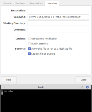

That's odd. It worked for me. Here's the launcher properties I used and the window it creates.
Maybe xterm is not installed for you?
