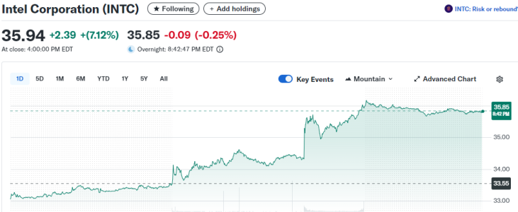

johnsonwax
Jun 27, 2024
472
676
A: The best answer SemiAccurate has heard from multiple sources is that it appears that someone was trying to cover a short. We are not financial folk here so we can’t say but that was the opinion of several finance folk we talked to.
Back in the mid-aughts one of the better ways to make money was to listen to Jim Cramer on his CNBC show. He was also running a hedge fund at the time just like now, and right before options expiry if he floated a rumor, you could check where interest in options were at that time and based on whether the rumor was positive or negative, figure out what side of a trade he was trying to cover with the rumor and bet against that. I bought 3 cars off of that kind of thing. Apple was a favorite of his going way back, and he's only gotten more open in terms of pumping/dumping since then since clearly regulators don't give a shit that he's manipulating the market.
This sort of thing happens all the time and given how big a short target Intel was, I wouldn't find this the least bit surprising. SemiAccurate may be disappointed that the rumors get picked up, but good lord, this has been a thing for decades.
