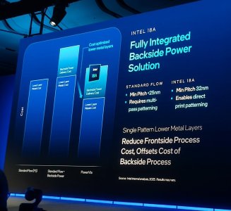

That slide has "Best Wafers" at the lower left.
Do they mean only the best wafers have that HVM (DO)? If yes, then what is the # for the average wafer?
In short, is this some BS/misdirection?
No units in that graph on the y axis and introducing on new term "Best Wafers" with no definition of what it means.
Intel tries to hide something.
Obviously based on that graph the answer to your question is not feasible to answer.
But from the looks of that defect density plot; they're about a year away from having their average wafers being at the level of the best wafers today.
Best wafers can be the best wafer they have matches the DD of HVM while average is lot less

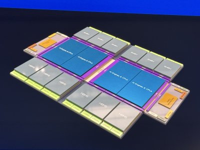

Interesting...
Is this Falcon or Jaguar Shores?

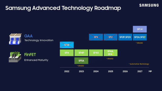

Hmm, Samsung screwed up again?
511
Jul 12, 2024
5,278
4,706
Bruh Samsung is screwing around more than Intel at this point
Interesting, but not surprising, given that tariffs may have affected their decision.

3 vendors have GAA without BSPDN even Intel.
Yeah, I know this too.
However, I don't know what about yield of GAAFET w/o BSPDN in Intel and it looks like Samsung's is bad for 3 years.
