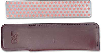

You can also go with Lansky/DMT systems, straight-up benchstones (Arkansas, waterstones, or india stones) or even incorporate a strop.
