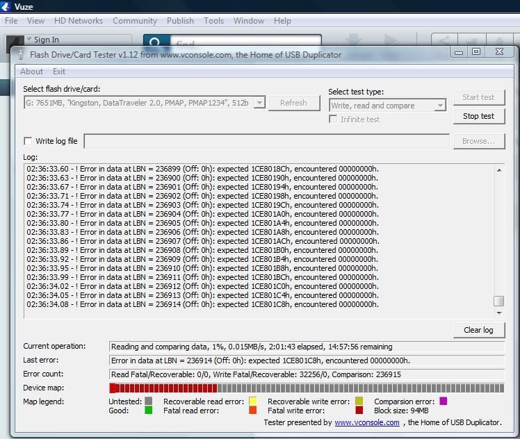

this flash drive tester can completely erase any existing file system/partition data in its destructive full write, then read test mode. it should zap any existing funny stuff on the drive.

Thanks, I'm running that right now. I probably should have done the HP utility first though, as the ETA to finish this one is about 80 minutes, lol

There were three options: read, write, and read+write together. I did the read + write, I'm assuming this is the right one?
I'm getting "! Error in data at LBN = *sector #* (Off:0h): expected 14600FC, encountered 000000h", or something like that. Sound normal?
yep, if its the one that warns you that all data will be destroyed. its the one that say write, read and compare.
that error is not normal. I do remember when new drives are tested the 1st few blocks sometimes come up as "recoverable error" but subsequent test come up as normal. its only done that on brand new drives on initial testing and never after the 1st run. at no time have I ever got an error like yours except on a POS ebay drive that was a fake 8 gig drive. no more ebay drives for me (never should if been a 1st really).
I would run it again and see what it says. only the one error?

I got the recoverable error bit for the first part, maybe it was getting that error on the 2gb partition thats already existing. Right now I've been getting that error on every sector since the 32256th, and it's on the 235000th. Now it says 14 hours left, I'm just going to abort and try the HP utility I think

only time I got all red like was that fake ebay "8 gig" flash drive. it was a no name from china, which should of clued me in, but hey live and learn..
Ive used that program on every new flash drive I get (about a dozen so far) and have never had any reputable brand give any errors aside from the initial few "recoverable" ones. not sure why some do that but after that initial test they come up perfect on all subsequent runs.
