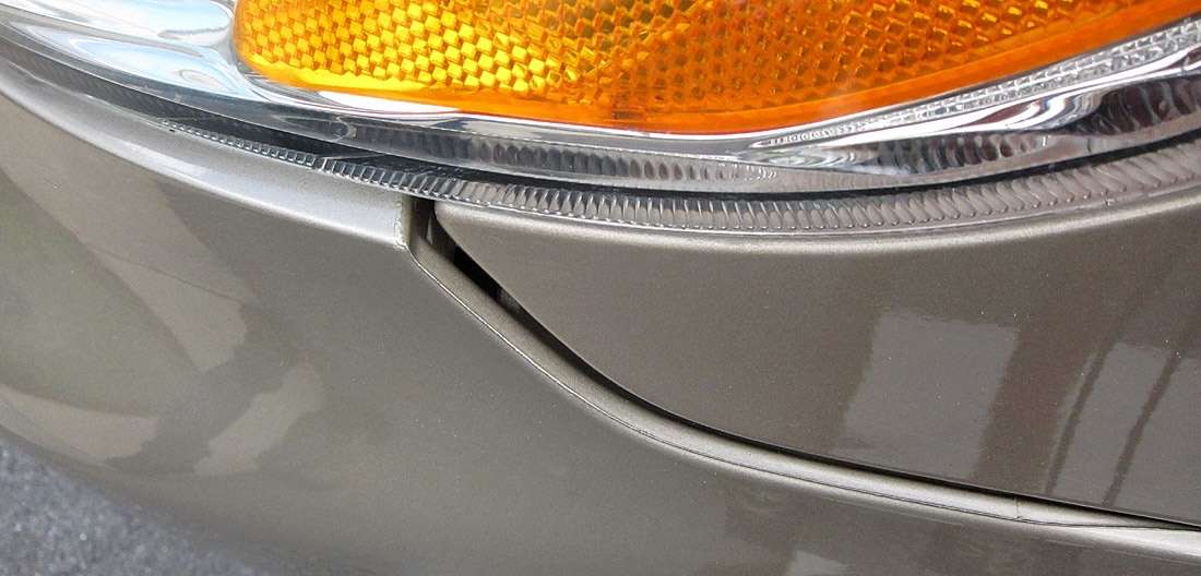

Above picture shows large dent in the side of the plastic “painted “ bumper bar, Early Kia people mover., the paint is falling off most of the bumper,
Please note, the dent was caused in a collision with another car of the same colour, plastic to plastic only, no gouging or scraping,
Two blue arrows shows the main 2 dents I will heat and massage with little pressure from behind, first,
Red arrows show the outside of the dent with the front crease line at almost right angles, ( some white milky stress line showing to my eye, but not so much seen in this picture, ),
Green arrow on right shows plastic clip with metal screw has been ripped out of the guard and is misaligned, new guys please note, a point to remember is if plastic clip has been ripped out of the “ HOLE” in a metal guard as above, the hole in the metal guard is likely to be opened up or deformed, please note, the metal hole in the guard should be repaired before reassembly, or the plastic clip will not tighten up, just spin,

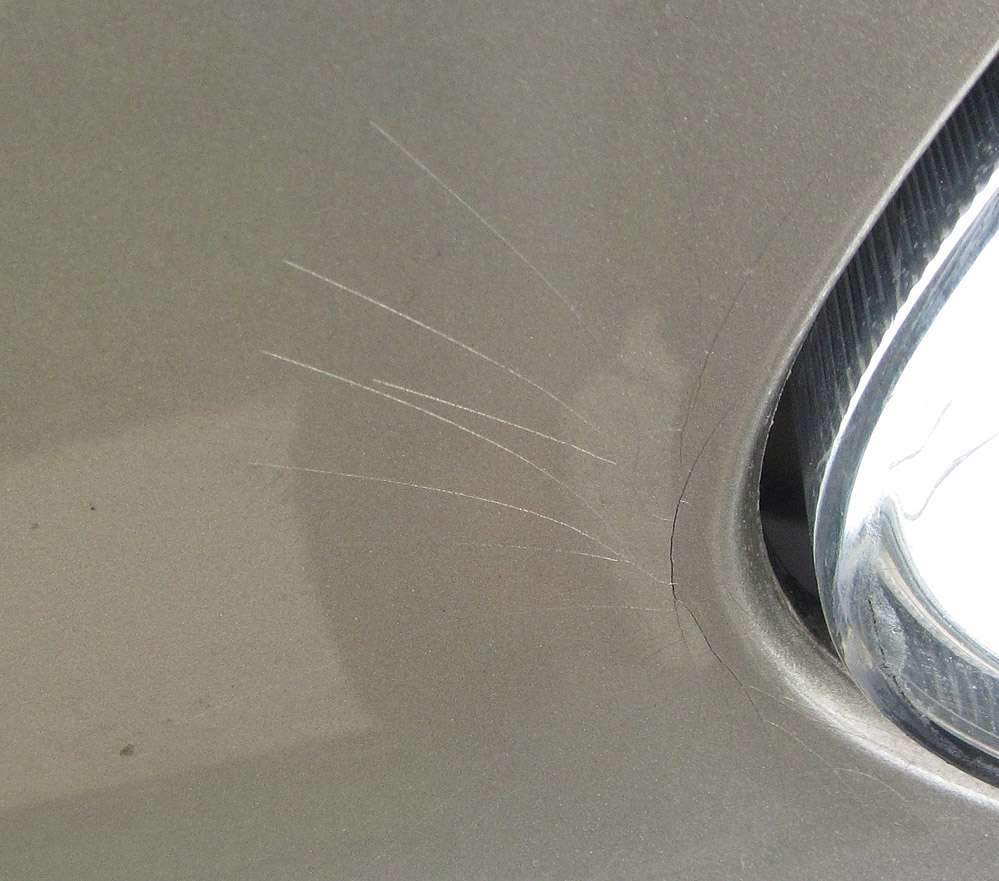

Black arrows show very closely aligned edges, only a fine gap and molten weld extruded during this welding method, a slight sand off of all old paint and ready for new paint, actually provided the method is followed, it is near impossible to stuff it up,
Blue arrows show point of impact, slight crease and stretching damage, cracked paint surface, please note, I popped the larger dent, then welded the crack to support and make it easier to heat and massage this small area, which has a crease and is stretched, a point I note here is I know if I heat and massage the creased and stretched areas, and allow to cool back to its original shape, by “it self”, if it does not, it is because I not heat and massage as much as I thought I did,

My neighbor's Corolla got hit and the repair shop say it doesn't need replacing....the question I'd have for NON-DIYers is can you trust a shop to repair the bumper plastic cover to have the structural integrity of a new one...
Polishing a bumper, removing the "other" bumper's residue, isn't all that difficult in minor scrapes...but removing and realigning it is critical...and necessary for structural integrity....the repair shop wasn't going to replace this bumper, just repaint it as they claim that the "hit" didn't crack the plastic beneath the paint, so they said...but were going to charge $1000 to just paint and reinstall the bumper....
I cleaned it up for my neighbor anyway...
....and once cleaned up you can see that the impact did more than crack the paint...
and the aligning will require more than just replacement as seen above around the grill, and below around the light...
There's more than meets the uncritical eye....if I were taking it to a shop I'd want it replaced...period!
