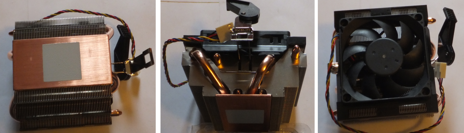

Does anyone know what a HS78 Class (D3) heatsink is? See footnotes on that table which indicates A10-8850K requires that heatsink.
I was curious about that too so I did some searching. The only thing I found was this PDF: http://support.amd.com/TechDocs/43375.pdf
Inside that there is only one mention of the HS78. Right above it, there is a mention of thermal profile AE. Then if you search for AE you find that thermal profile under certain cpus, like the HDT55TFBK6DGR and HDT90ZFBK6DGR. Now if you search cpu-world for those cpus it says those have a 125W TDP. They came with the well known AMD heatspipe heatsink.
My guess is that this new top of the line Godavari APU will come with that Phenom II heatpipe heatsink as well.

Regarding overclocking on cheap boards (without heatsink on VRMs), I do wonder if the next FM2+ APU flagship comes with the AMD 125 watt cooler:
http://forums.anandtech.com/showpost.php?p=37344069&postcount=32
And how that would turn out compared to using a tower cooler?
Not only was it rumored to come with the FX series cooler...if you look at the package shot of the 7870K above...You can tell that this thing is a lot bigger than the other Athlon and Kaveri boxes.
The only reason this thing would be bigger is if it was housing a bigger heatsink/fan. 🙂

That the heatsink of the Godavari? Because that looks like what is used for FX. (I got an unused FX + a FM2+ heatsink/fan in my "parts" box...and that heatsink looks just like FX.)
I mean...in the end 7870K is just a 7850K with updated stepping, mild CPU overclock and not-so-mild GPU overclock....the mini Kaveri solution would not work at all...the thing would legitimately throttle because of heat...luckily AMD didn't change the socket mounting for like the past 6 mainstream socket generations. Good guy AMD.
That s what is displayed with the rest of the gear, look to be the stock cooler :
http://www.overclock.net/t/1555615/amd-kaveri-refresh-a10-7870k-apu-arrives
