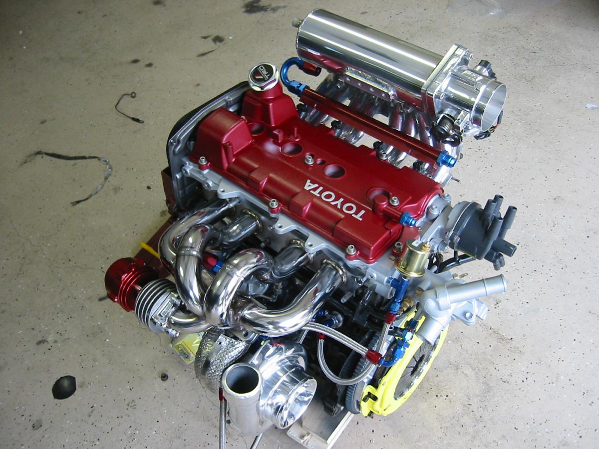

I want to see you posting a pic like this down the road:
yeeesh! I'd have to live in a nice dry desert first, where it would never see water :p
Speaking of clean...any recommendations on how to remove all the oil and grime without dropping the engine?
exdeath
Jan 29, 2004
13,679
10
Disconnect all the harness and electrical stuff, move everything out of the way like you're doing a engine bay tuck, then soak it down with a couple cans of engine degreaser then hose it down with a pressure washer. Actually, pressure washer alone is probably sufficient, but you can use degreaser and a garden hose.
That pic is all fresh paint and aluminum parts scrubbed with aluminum cleaner (and then painted?) though. Not getting that without a rebuild and hours of detailing.

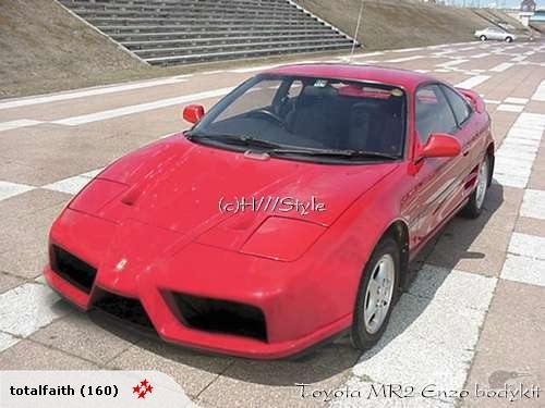

HAHA, I was searching for that pic with the mr2 with the huge turbine exhaust, but I found this: You need a new front end jlee
