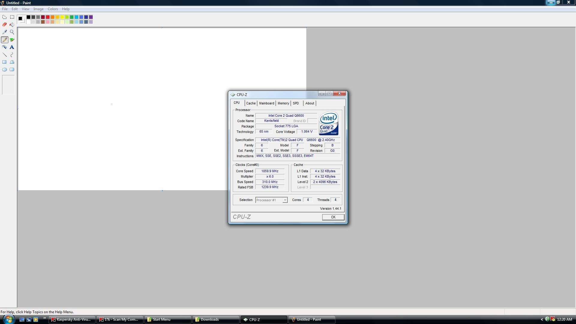

Well I know that Vdroop isn't good for overclocking, but is it harmful in anyway beyond that? I know you can fry a CPU with too much voltage, but is too little voltage also a bad thing?
Here's a pic of what CPUZ says my Vcore is:
http://i189.photobucket.com/al...bucket/megavdroop1.jpg
It's set in the BIOS as 1.225V which is the lowest setting. I've found at that setting I can overclock to 310 mhz stable so I left it at that. However the Core Voltage according to CPUZ is something else. It jumps from 1.2 something all the way down to 1.00 (I've seen once. Usually it's between 1.072 and 1.84 Volts though. I've herad that a big vdroop might be a sign of motherboard failure so I'm a little worried.
Also I don't want to ruin my CPU if the fluctuations are bad for it. I'd much rather get a new board if that's the case.
Also just curious, but what kind of Vdroop does everyone else get? I mean how low/high does it get?

EDIT: Original Poster... do you have C1E and/or EIST enabled in BIOS?? Vdroop is about the voltage drop that occurs when your CPU is *under load*. The power saving mechanisms will probably both lower your CPU multiplier to 6 and also lower your vcore if your processor is at *idle state*!
Disable the power saving options to see if your vcore is the same than what you set it to be. After that run some CPU stressing application and during the run, open CPU-Z and check your vcore to see the "Vdroop".
